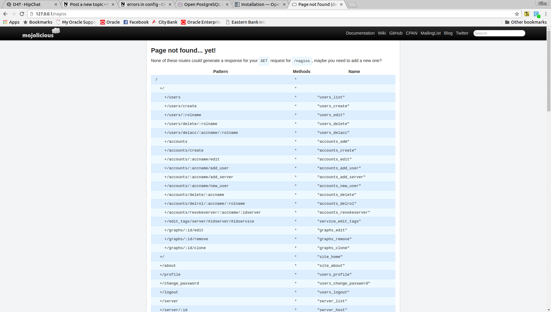

I am unable to access nagios web interface. The page I am getting has been attached as image.

What operating system is Nagios installed on?
Did you follow any specific guide to get it up and running? If so can you post a link to it please.

Nagios is installed on ubuntu 14.04. I have followed following link:
https://help.ubuntu.com/lts/serverguide/nagios.html

It looks like you have another application on port 80. What is the output of netstat -anp | grep 80?
It may be worth installing Core on it's own Ubuntu machine, and following our official instructions which are for the newest version of Core. https://support.nagios.com/kb/article.php?id=97

giles@giles-S451LA:~$ netstat -anp | grep 80
(Not all processes could be identified, non-owned process info
will not be shown, you would have to be root to see it all.)
tcp 0 0 0.0.0.0:80 0.0.0.0:* LISTEN -

As recommended by @rkennedy, Nagios Core really should live on it's own clean, minimal machine. There's an awful lot of considerations for just the Apache configuration when Nagios attempts to co-exist with other applications installed on the server. At that point, it's less about troubleshooting Nagios Core and more about troubleshooting the other applications.

The problem is solved.
