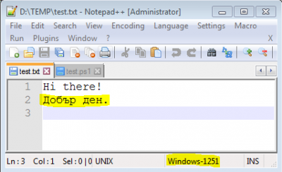

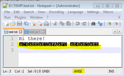

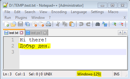

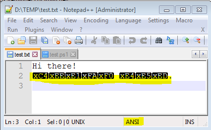

At this point, I will need to say that this issue has nothing to do with Nagios. It is a Windows/PS issue. Similar issues have been reported here:
http://docs.notepad-plus-plus.org/index ... er_Display
and here:
https://connect.microsoft.com/PowerShel ... nsole-font
I was able to recreate the problem by selecting "Windows-1251", entering some cyrillic text, then changing the encoding to "UTF-8". The cyrillic characters become unreadable.
I also tried running a simple PS script against my test file:
$text = Get-Content -Path D:\Temp\test.txt
Write-Host "$text"
As you can see, this issue has nothing to do with Nagios.
