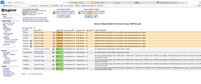

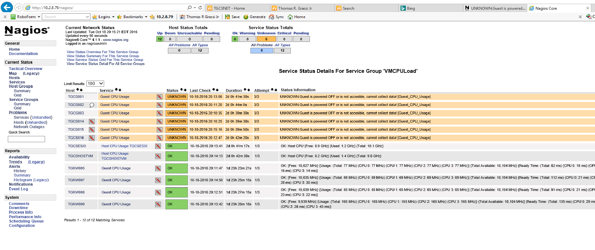

I believe the numbers are just mixed up here, could you post two things for us to help compare?
1. A copy of your /usr/local/nagios/var/objects.cache (path may vary depending on how you installed) - Feel free to PM this over if it contains sensitive data.
2. A screenshot showing us the working checks, and the non-working checks.

screen shot and file is attached.

screen shot
screen shot
