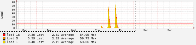

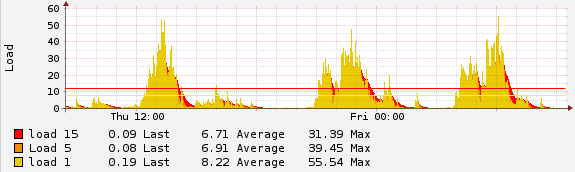

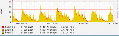

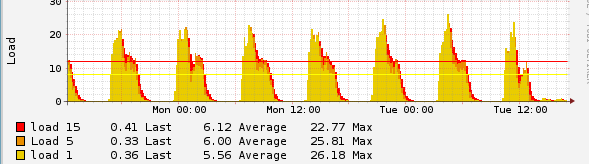

Sorry to bump an old thread, but I'm experiencing very similar behaviour on some Nagios hosts I've recently built. Initially I built a RHEL7 host using Nagios 4.0.8 that comes with the distro, but I've since built an identical instance using 4.2.1 from source in hope that it may have been due to a bug that has been fixed, but it's also showing the same behaviour. In fact all hosts I've built across test, stage and our production environments are showing the same regular spikey load patterns. The hosts seem to perform fine even when exhibiting these high load spikes.
The auto rescheduler is already disabled:
$ grep auto nagios.cfg
auto_reschedule_checks=0
auto_rescheduling_interval=30
auto_rescheduling_window=180
I've attached a sample of load graphs from my hosts. The busiest of these servers has around 140 hosts with just shy of 4000 service checks.

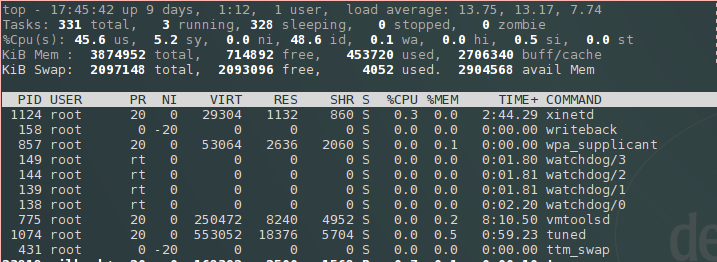

Just grabbed a couple of outputs from one of our boxes that's just hitting spike-o-clock. Image attached, outputs to follow.
Posts: 4583
Re: Nagios 4 Load issues
Post by dwhitfield »
top -bcn1 will actually show different output. Could you post that? Thanks!

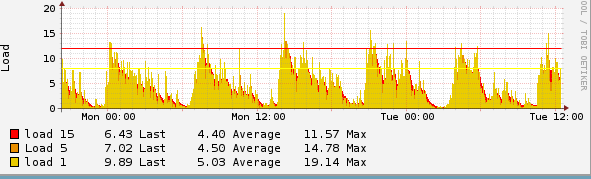

Apologies, not had chance to post that data today. However, attached is a screenshot of the load from the 4.2.1 host that I set auto_reschedule_checks=1 on Friday afternoon. The load now looks perfect. I'll try this on the 4.0.8 hosts tomorrow and see how that progresses.
Posts: 4583
Good to hear things are working on 4.2.1. We await word on 4.0.8.
