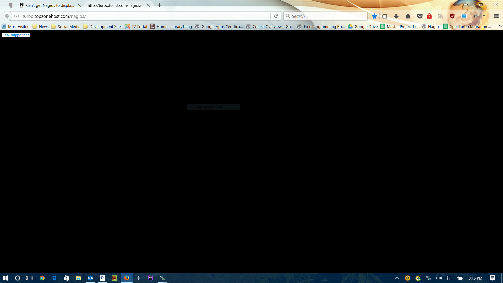

I am having trouble getting Nagios running. I know the service is running, but if I go to the nagios application in the browser and log in, I get a black screen. If, however, you "highlight" the words, I see "Not supported" displayed.
I am running Nagios core, version 4.1.1 (or latest when I installed it) running on CentOS 7. I followed the directions located here: https://assets.nagios.com/downloads/nag ... entos7.pdf - with no error messages.
What am I doing wrong?

Can you attach a screenshot of this:
Previous Nagios employee
Re: Can't get Nagios to display
I've attached a screen shot. And I double checked - I am using version 4.2.2, with plugins version 2.1.2.

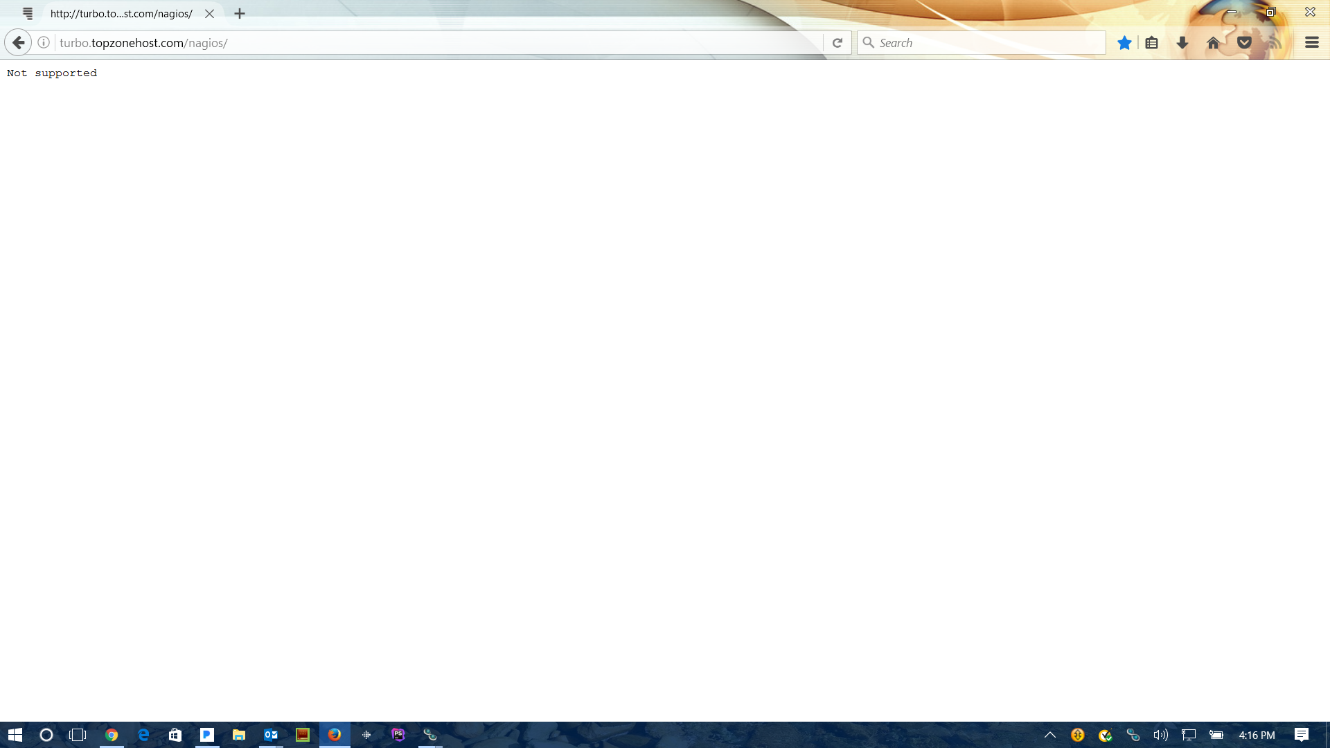

I can pull up the login just fine - this screen is what happens immediately after logging in.

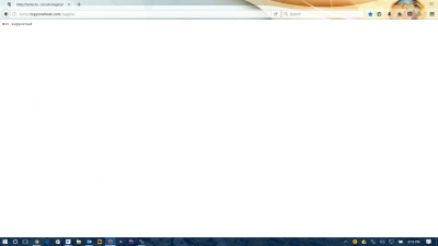

What happens when you use Firefox safemode? https://support.mozilla.org/en-US/kb/tr ... -safe-mode
Same thing, except the CSS seems to be working... see image attached.
