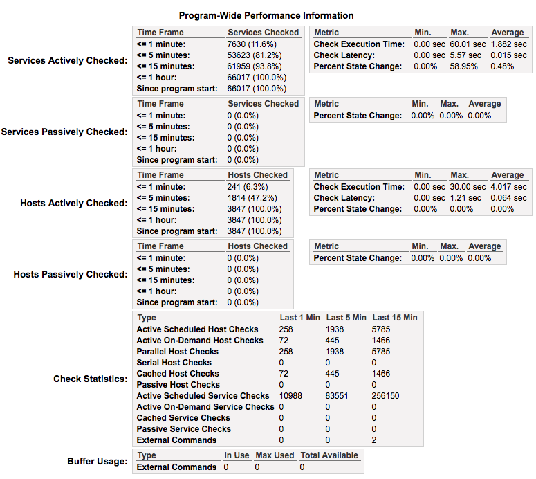

Can you go to the Performance Info menu in the Nagios GUI, screen capture that and post it here?

Sep 14 17:18:31 nagios10w100m3 nagios: job 192020 (pid=108766): read() returned error 11I've attached a screenshot from the Performance Info page.
