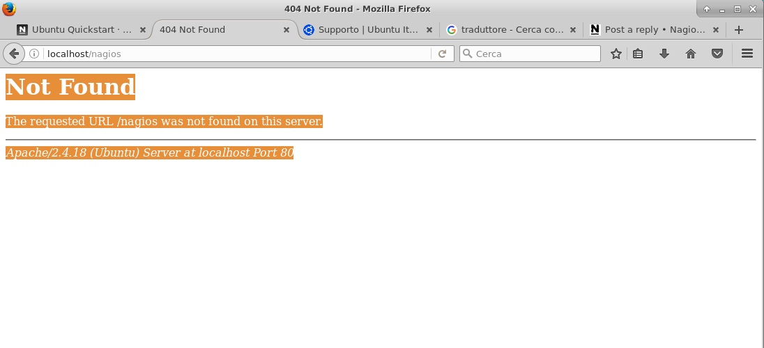

Hello everyone, I have a problem with nogios that I can not solve; I installed ubuntu 10.16 on a dual core machine with 2gb ram ddr2.
After doing some updates, I installed xrdp and xfce environment, in order to achieve it through a Windows machine. Right after I downloaded, unpacked and installed Nagios Core through this guide:
https://assets.nagios.com/downloads/nag ... buntu.html
the only difficulty I found is installing plugins as the URL of the guide was wrong (probably changed), and found the new url, in fact everything went well.
Unfortunately at the end of the installation, when I try to connect to: http: // localhost / nagios. I get 404 Not Found, namely:
not Found
The requested URL / nagios was not found on this server.
Apache / 2.4.18 (Ubuntu) Server at localhost Port 80
can you help me please? thank you

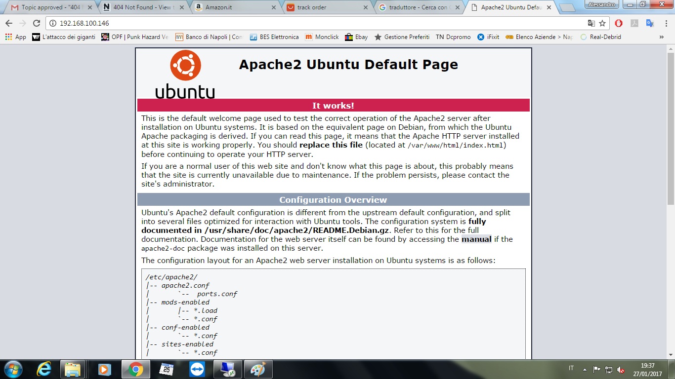

If I try to connect from Ubuntu machine: http: // localhost / nagios out the first image.
While on windows if I go on 192.168.100.146 (ubuntu ip) exits the second image.
I have no other Web software with which to see if they work.

Apache is running, so yay for that. Since you aren't running anything else, it should be pretty easy to get you up and running.
