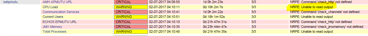

rahul.srivastava1

This is working while i am running it manually.
But on the dashboard i still see the error.
Attached PNG image from dashboard.
Regards,
Rahul
Regards,
Rahul
Re: NRPE: Unable to read output in Solaris 10
A lot of the errors are for commands that are not defined in the nrpe.cfg file so can you verify that you are loading the correct one?
If the nrpe.cfg file doesn't have the commands defined, put them in there and restart the nrpe service.
Also, can you run the following and post the output?
inetadm
find / -name nrpe.cfgBe sure to check out our Knowledgebase for helpful articles and solutions!

I am attaching the latest nrpe.cfg. I have included the command and restarted the nrpe service.
Also, here is the info that you asked.
Did the errors go away after adding the missing commands?
In the last post, which nrpe.cfg file is it?
If you are still seeing the errors, can you run the following and post the output?
If the errors changed, please post them as well.
/usr/local/nagios/etc/nrpe.cfg
or
/apps/nagios/etc/nrpe.cfgCode: Select all
inetadm -l svc:/network/nrpe/tcp:defaultBe sure to check out our Knowledgebase for helpful articles and solutions!
