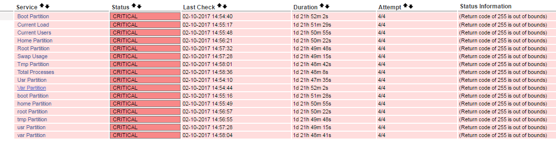

i have added new server in nagios and when i run service nagios restart its working good with no issue but in the nagios gui and i see this error message

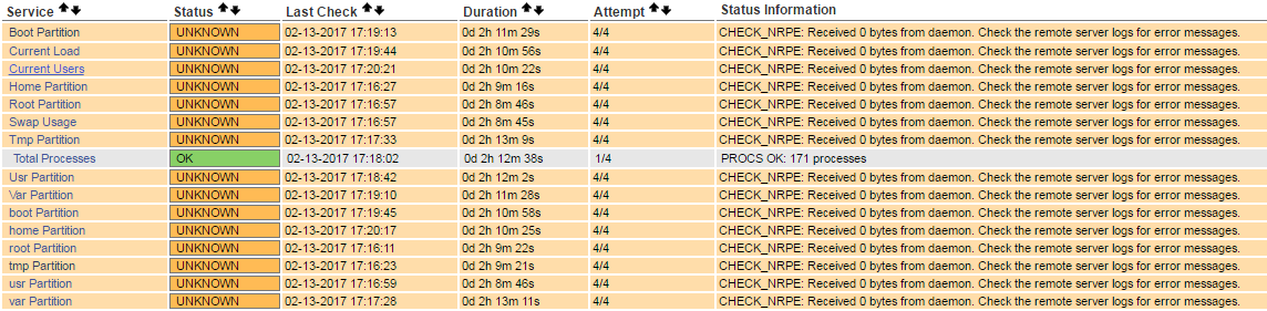

Here are the error message i am getting as per screen shot

So, we have progress!
Did you look at Section V. CHECK_NRPE: Received 0 Bytes From Daemon. Check The Remote Server Logs For Error Messages, starting on page 6 of https://assets.nagios.com/downloads/nag ... utions.pdf ?
Can you attach your /usr/local/nagios/etc/nrpe.cfg ? I asked about Core, but I will about NRPE. Did you using a binary we provided or did you compile from source? If a binary, could you point us to the download? If source, could you point us to the instructions you used to compile? Thanks!
