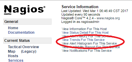

On Centos 7 and using the EPEL repo, I Updated from nagios-4.0.8-2.el7.x86_64 to 4.2.4-2.el7.x86_64 and now the links for trends and histogram are broken. All the other links seem to be working fine. All links worked prior to the update.
Example of links (spaces added for readability):
http:// nagios/nagios/cgi-bin/trends.html?host=somehost&service=someservice
http:// nagios/nagios/cgi-bin/histogram.html?host=somehost&service=someservice
I get the error message: The requested URL /nagios/cgi-bin/trends.html was not found on this server.
Which makes sense because those html files are not in the cgi-bin directory, they are in the html directory.
Did I just not search the forums hard enough? Can anyone point me in the right direction to resolve this?
Any help would be appreciated. Thanks.

The date stamp on side.php matches the date the update was done and the code matches what you have exactly.
I realize side.php is for the menu on the left. Those links are working. The links in question are the trends and histogram links in the top left corner of a service screen.
The httpd error log shows this:
With those links, it is looking for the html in the cgi-bin instead of the html directory where they are.
To further confuse me, if I inspect the linkbox with Chrome developer tools, the urls are reflected properly: "../trends.html?host=somehost&service=someservice" I can even copy them from developer tools and paste into the browser and it works as expected. So, is this an httpd issue? The browser is not following the parent url "../" and moving back one directory.
I can clearly see what's going on, I just don't know why and it's driving me headsmashingly nuts.
[Wed Mar 01 06:55:06.633426 2017] [cgi:error] script not found or unable to stat: /usr/lib64/nagios/cgi-bin/trends.html, referer: http://nagios/nagios/cgi-bin//extinfo.cgi?type=2&host=somehost&service=someservice

...and if I edit the url in developer tools to add and additional ../ to the beginning, the links works as expected. so, for some reason on my installation, to work properly it needs to be
../../trends.html?host=somehost&service=someserviceRe: Links Broken after EPEL update to 4.2.4

I was able to replicate the broken links in the Service Information and the Host Information menus and I filed a bug report at the Redhat Bugzilla site for you.
https://bugzilla.redhat.com/show_bug.cgi?id=1428111
