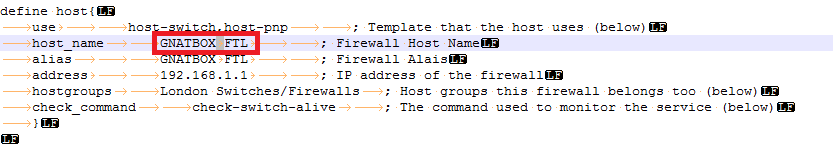

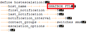

This actually looks like a spacing issue with how the host is defined:
A tab seems to be used in the host definition, where a space is used in the hostescalation definition. Can you try modifying those particular definitions to see if this observation is consistent?
FTL
Posts: 72
Joined: Fri Oct 21, 2011 7:23 am
Re: Pre-flight error, but i cant see it :(
Post by FTL »
mcapra you star.
Nailed it.
Thankyou :)
