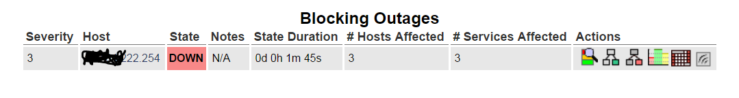

1. Submit passive check result for router host(xxx.xxx.222.254)
2. Select "Down" for Check Result
3. Enter "testing router outage" for Check Output filed
4. Commit
5. This down status will be valid for about 5 minutes(?) and will be reset to UP.
6. We should be able to see this picture(outage-simulation.png)
network outage picture
6.1 from https://nagios03.test.com/nagios/cgi-bin/outages.cgi
6.2 it report 3 devices got impacted, two other devices and this device.
7. When click on 3rd icon from the left to see 3D map and its impacted childs

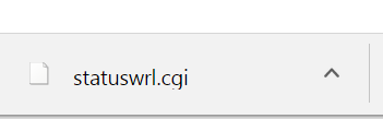

My Chrome browser download as a file.
statuswrl.cgi got downloaded as file
8. Looks I have a httpd cgi configuration issue for 3D wrl file
Sorry, Another question. Do you know where is the doc I can see to configure 3D wrl cgi properly ?
Here is more information, other *.cgi are working fine except this one.
So this is not a cgi-bin path declaration issue in apache.
9. found this thread http://www.phppop.net/node/243
I install this one https://chrome.google.com/webstore/deta ... lcao?hl=en
restart Chrome and still getting same issue, statuswrl.cgi got downloaded.
