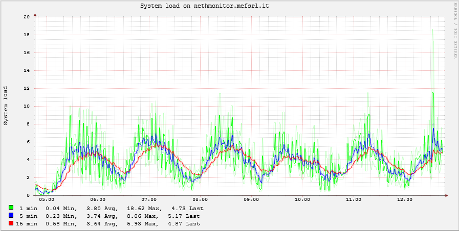

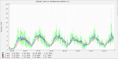

I notice a very strange peak load cyclic, h24x7day (see tha attach LOAD.png)

The change (use_large_installation_tweaks=1) no solve the problem
However I realy don't understand the reason of the load peak:
- why the load grow..
- why after reaching a value 4/6 the load decrease. There is something that limit the peak??
Someone can give me some information?
Thank you

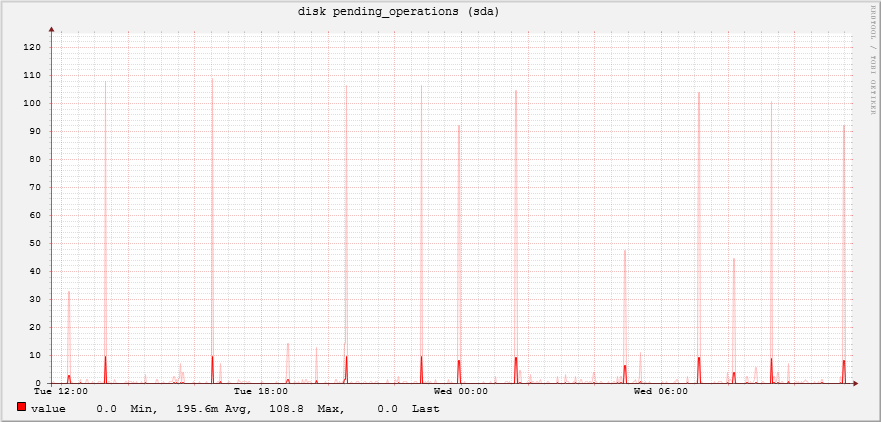

Also, I see the graph attach (disk pending operations) that have frequently disk access. Is possibile that is combine with the load peak?Do you the reason of this disk access about nagios?

Posts: 3739
Re: nagios/adagios slow
Post by mcapra »
How many hosts/services is this machine handling?
stefanotoni wrote: I notice that consider 16,46GB ram, used 15,88 GB ram. Swap used 73MB
Is possibile that the memory in not enough and the system swap to the disk (loading the server resource?)
That's very possible. Have you tried adding more RAM to this machine?
