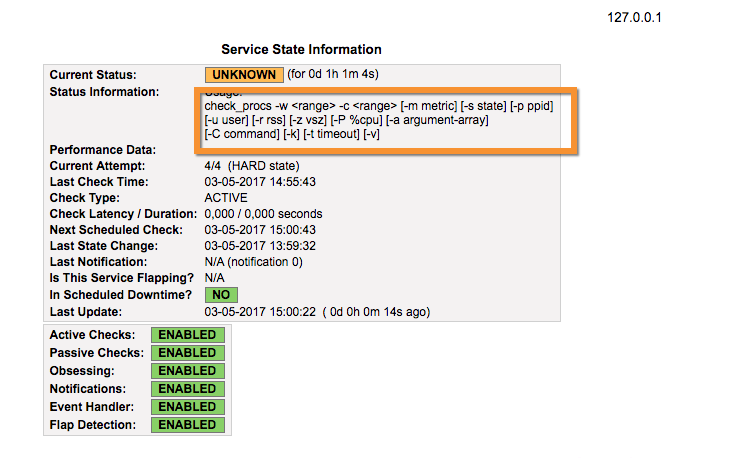

I tried get information with help default plugin "check_procs" on local server. But in web interface i can see UNKNOWN Status.
There are my settings:
In server.cfg
        use                             local-service         ; Name of service template to use
        notification_interval		0
        hostgroup_name                  Servers
        service_description             Total Processes
	check_command			check_procs
In nrpe.cfg
command[check_procs]=/usr/local/nagios/libexec/check_procs -w 150 -c 200
In command.cfg
        command_name    check_procs
        command_line    $USER1$/check_procs -H $HOSTADDRESS$ -w 500 -c 300
What the problem? If i runing command - ./libexec/check_nrpe -H localhost -c check_procs, it work correctly.
Thanks!

The check_procs command only runs on the local system and the -H $HOSTADDRESS$ option is not needed in the command definition and that is causing the error.
Edit your check_procs command and change the command_line from
to
command_line    $USER1$/check_procs -w 500 -c 300
Save the settings and restart nagios and that should fix it for you.

Thanks, it is works. But if i need to check other servers with this plugin i must edit nrpe.cfg for it?

By default it should be in your /usr/local/nagios/etc/nrpe/common.cfg on the remote server:
command[check_procs]=/usr/local/nagios/libexec/check_procs $ARG1$
If you do not have that file on the remote server you can just define it in your nrpe.cfg file (if it isn't already).
Then to test, just run this from the XI server:
- Change X.X.X.X to the remote address
/usr/local/nagios/libexec/check_nrpe -H X.X.X.X -c check_procs -a '-w 500 -c 300'

As long as the check_procs command is defined in the nrpe.cfg file like your example below and the plugin is installed on the remote server, you should be alright.
Now this service definition
With this command
Will only run the check_procs plugin on the local nagios server.
To get it to run on a remote server using NRPE you would define a check_nrpe command like the example below
       command_name                             check_nrpe
       command_line                             $USER1$/check_nrpe -H $HOSTADDRESS$ -c $ARG1$ $ARG2$
And the service check would look like this for example
        host_name                       192.168.1.1
        check_command                   check_nrpe!check_procs
That service check uses the check_nrpe command to run the check_procs command on the remote host 192.168.1.1 returning the number of processes running.
