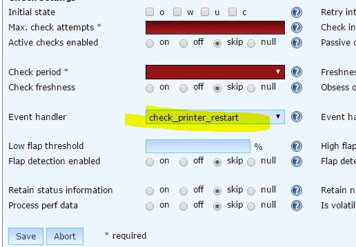

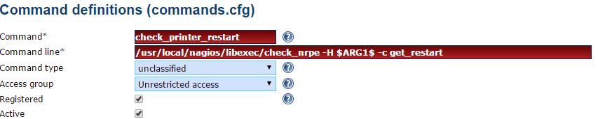

Here is the Check Command itself:
Here is the Event Handler setting: The rest are blank because I have a service template for the other configs.. I also tried the Event setting in the service template as well..

Sorry.. here is the side showing enabled as well...

Your test shows that you ran the check_nrpe command from the /usr/lib64/nagios/plugins folder but the command is using the /usr/local/nagios/libexec folder.
Verify that the path it correct and that the plugin is executible by the nagios user account as well as the nagios group.

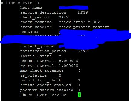

The nagios.log file shows that the event runs so maybe the settings in the SQL database it not getting written to the nagios cfg files.
Can you login to the nagios server as root and check the config file for that service and see if it is configured correctly.
Also, there is a file called objects.cache on the server, typically it is in the /usr/local/nagios/var folder and that file has the current running configuration.
Can you look in that file, check to see if the command is setup correctly and also the service check is setup correctly.
Post those entries here so we can view them.

That's what I thought as well.. I viewed the cfg files that the DB writes to and they match.

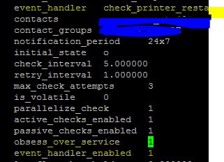

The config file looks like the the handler is defined but the event handler is not enabled so there is something wrong there.
event_handler_enabled 1

Sorry.. part of my screenshot was cut off.. but that enabled 1 is there.
