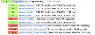

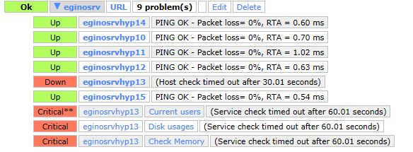

I have configured BPI on nagios core and created new group , added some members to that group.
But it is not showing proper status. Even Essential group member is critical but group status shows OK status.
Also in this group actual problems are 4 but it shows 9 problems at group level.
Could you please help me to solve this issue?
