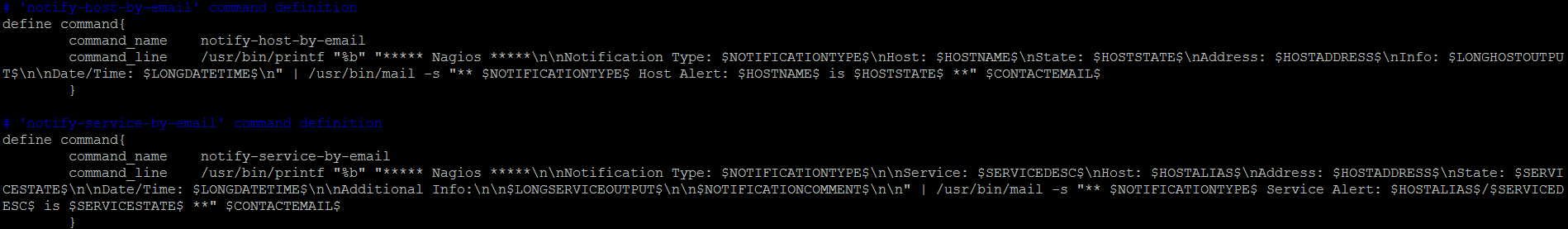

I attached the command as a screenshot. I'm getting a nothing back on the LONGSERVICEOUT marco

Re: Email Notification - Is there a way to display the error
I'm actually looking for the command that produces this output:
Not the command you are using for your notifications. Again, the various OUTPUT macros rely completely and entirely on what the plugin gives you, so it's valuable to know what, if anything, a given plugin produces.
