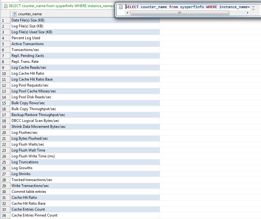

When I'm running instead the following SQL Command (I'm only connected to the SQL Server not to an insatance):
SELECT cntr_value,counter_name,instance_name FROM Vudyog.sys.sysperfinfo WHERE instance_name='CHECKTABLE ';

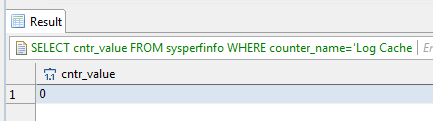

I got a list with many information inside. Therefore I tried
SELECT cntr_value FROM sysperfinfo WHERE counter_name='Log Cache Hit Ratio' AND instance_name='CHECKTABLE ';
Last one works great and I also got a Value as you can see in the attachment:
2017-08-04 07_59_06-DBeaver - General - [ _MS SQL Server - 10.18.45.98_ Script-13 ].png
2017-08-04 07_59_06-DBeaver - General - [ _MS SQL Server - 10.18.45.98_ Script-13 ].png (3.71 KiB) Viewed 5369 times
So I didn't understand where there is my problem and how I can solve it. I got a connection with the check_mssql_database.py script but it seems that the script doesn't connect to the right DB/TABLE.

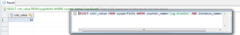

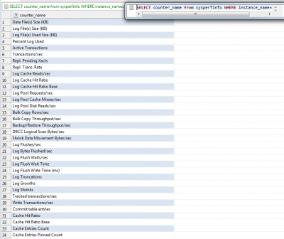

Hi, I've already verified that the Tables are there:
2017-08-08 08_23_08-DBeaver - General - [ _MS SQL Server - 10.18.45.98_ Script-13 ].png
And also by loggrowths works fine within the SQL client as you can see in the pic below:
2017-08-08 08_21_34-DBeaver - General - [ _MS SQL Server - 10.18.45.98_ Script-13 ].png
Just for Information we use MSSQL Server 2012 SP1
