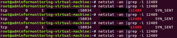

When i do the command on my VM i got this, i don't know why i got port 42682 for my VM. The port 12489 is for my server that i want to monitor :

I retried the same command after and i got this result :
and after a few second, i retried it and i got an other result :
I don't know what do i think ....

Re: Nagios CRITICAL - Socket timeout for check_nt request
DrNox wrote:When i do the command on my VM i got this, i don't know why i got port 42682 for my VM. The port 12489 is for my server that i want to monitor :
Port 42682 is the outbound port, this is totally normal
