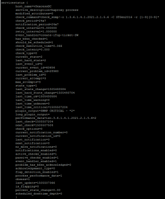

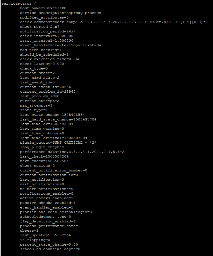

Here is the output of the status.dat file for that specific service:
Here is another picture of the command executed on the command line:
I'm still puzzled as to why the results are different in the command line and interface. Thanks in advance for the help.

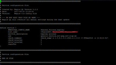

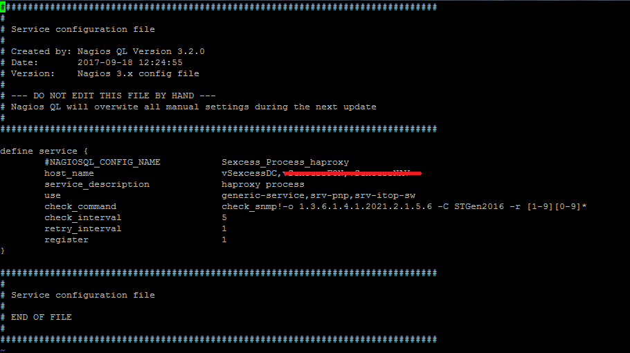

Can you post the config of the "haproxy process" service?

Here is the haproxy service configuration file:
Thanks in advance.
