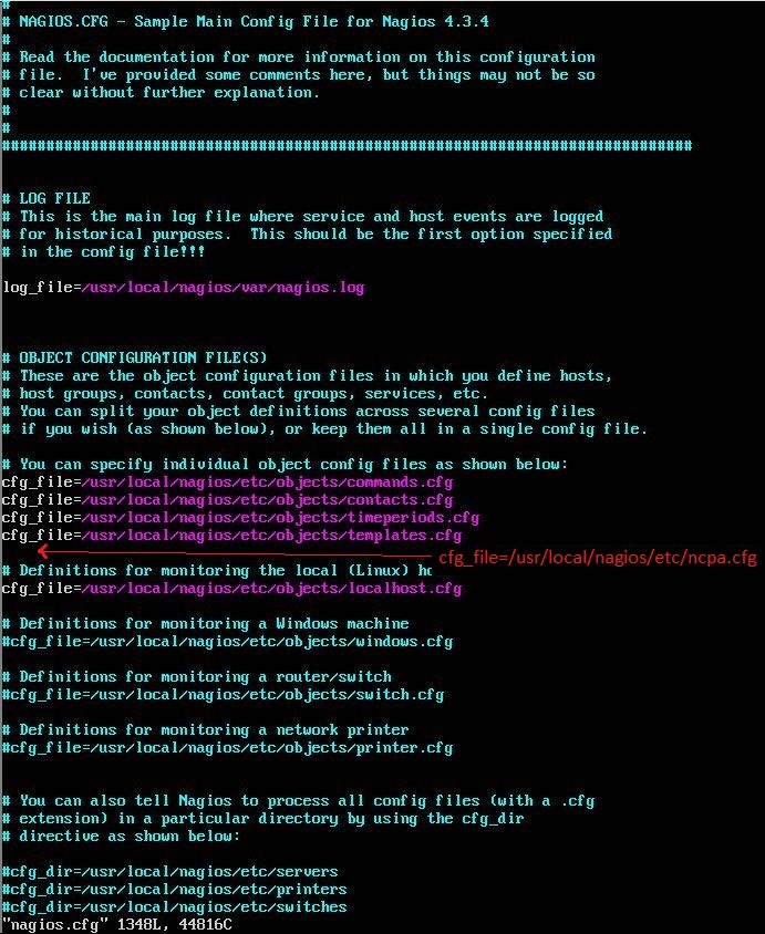

Hiya,
I can't seem to copy and paste so instead I've taken screenshots I hope it comes out OK. For security I've blanked out any IP addresses or passwords.

Hi, @karl. Thanks for the screenshots. Can you put this line inside your nagios.cfg file(as on the screenshot)
After that try restarting nagios one more time and see if you get any errors.
Let us know how it goes.
