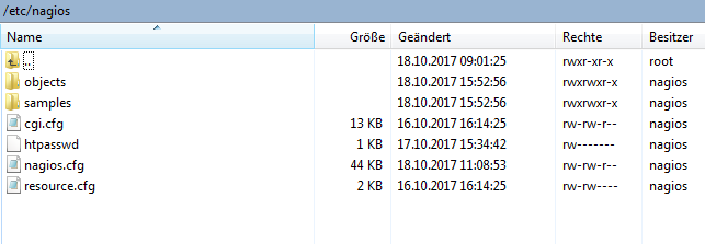

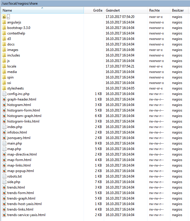

Hello Nagi-OS-surfers,
I installed Nagios Core 4.3.4 with Nagios Plugins 2.2.1 on a Hyper-V virtual machine with CentOS7 today and tried to adapt the configuration files for both nagios.cfg and httpd.conf.
My localhost IP address is 10.0.200.106. When I type it into the browser, I can see the nagios main page with the menu navigation bar on the left hand side.
I get the same result when I type 10.0.200.106/nagios.

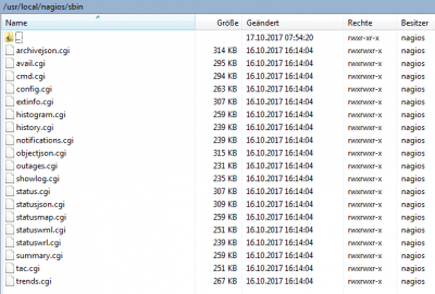

However, when I hit "Tactical Overview" in the menu navigation bar, I get this error: "Requested URL /nagios/cgi-bin/tac.cgi was not found on this server".
I get the same results when I hit other links in the "Current Status" area with similar errors: "Requested URL /nagios/cgi-bin/status.cgi was not found on this server" and "Requested URL /nagios/cgi-bin/outages.cgi was not found on this server".

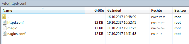

I thought it had something to do with wrong entries in my config-files (apache or nagios respectively).
So I checked httpd.conf, presuming that the cause for this error was the entry
AllowOverride AuthConfig
Options ExecCGI
SetHandler cgi-script
Order allow,deny
Allow from 10.0.200.106/16
</Directory>

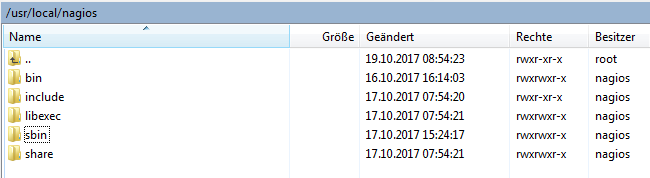

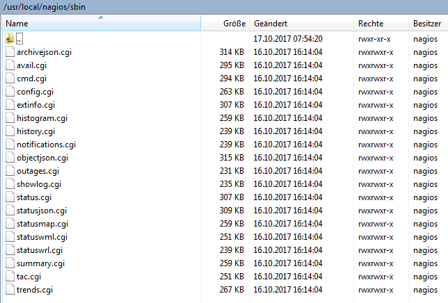

So I changed the ScriptAlias from /nagios/cgi-bin to /nagios/sbin, restarted both httpd and nagios but the error message did not even change to "Requested URL /nagios/sbin/tac.cgi was not found on this server", which I assumed would happen if the error did not disappear.
I figured that I needed to ask experienced Nagios-administrators for assistance before breaking something.
I hope you can help me if I provide you all the information you need about the config-files and Nagios/Apache(httpd) directories:

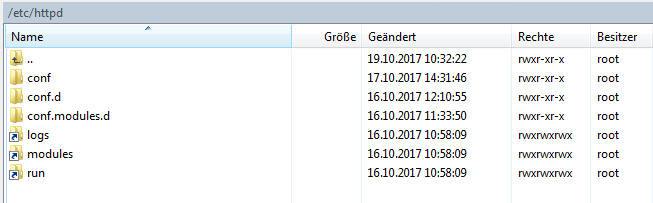

ServerRoot "/etc/httpd"

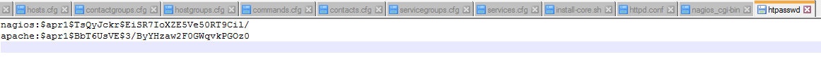

here is part 2 of the attachments:
cgi.cfg:

thanks for your readiness to help me. I edited my original post. Now there is an httpd.conf and nagios.cfg.
I changed the entry in cgi.cfg as you said and moved the nagios.cfg file to /usr/local/nagios/etc.
I had to make a directory because usr/local/nagios/etc did not exist.
After trying to restart nagios and apache I got a fatal error. I cannot restart neither apache nor nagios, does not matter whether I am root or superuser nagios, same result.
I sent some more pictures (3 are maximum unfortunately, I would have loved to send them in 1 post... :roll: )

Does the SCRIPTALIAS in httpd.conf need to come before the ALIAS? That is what I read in an older article.
Why does he not find /nagios/cgi-bin? It doesn't make any sense to me...I clearly gave him the correct ScriptAlias in httpd.conf.
My cgi-bins are in /usr/local/nagios/sbin!
Re: Requested URL "/nagios/cgi-bin" not found on server
What instructions did you use to install Nagios on the server?
It looks like there could be 2 different installs of Nagios on the server and the config file are pointing to the wrong entries, etc... causing the issues.
I suggest removing the current install and following these instructions to reinstall Nagios from source.
https://support.nagios.com/kb/article/nagios-core-installing-nagios-core-from-source.html
