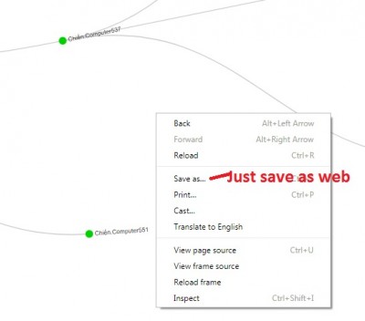

On my Nagios 4.3.2 I'm able to right-click on a blank space around or above the map and choose "save image as"
This allows me to save it as a png.
Sometimes I don't see the option, so if I keep left-clicking and then right-click it will eventually come up.

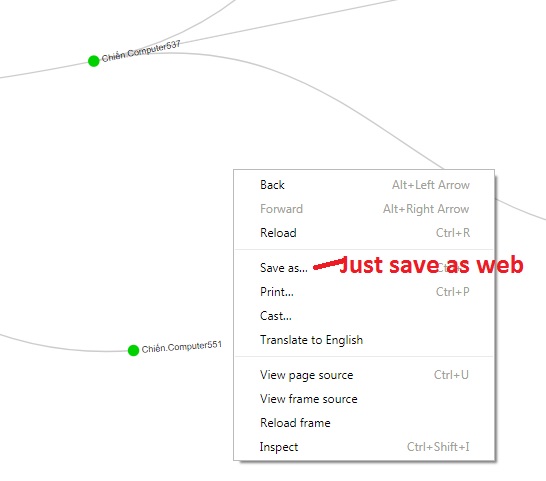

This is what mine looks like!
Let me know if this helps.

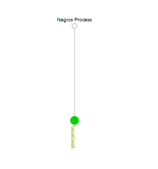

As your picture, i think the format of map on both version 4.0.4 and 4.3.2 are same .png image, but let's try with newer version 4.3.4, the map's really cool, you can zoom x10 with high quality of label, node,..but cannot save all map as a image file, that's the problem !

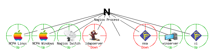

Doing this will only display the older map we mentioned before. A kb article explains a bit more.
https://support.nagios.com/kb/article/n ... egacy.html
Go to: open up the file cgi.cfg
/usr/local/nagios/etc/cgi.cfg
Scroll down or search for default_statusmap_layout=6
It's probably commented out so take out the "#", and make sure it looks like this.
After that, type this in your URL and it should create the map as an image
http://<nagiosIP>/nagios/cgi-bin/statusmap.cgi?createimage
I couldn't get this to work on the "new graph" in 4.3.4, so its likely something you would have to put in as a feature request on the Nagios Core Github.
https://github.com/NagiosEnterprises/nagioscore/issues
