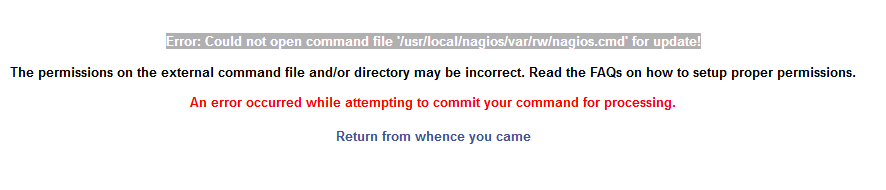

When I try to disable notification for any host it shows error as "Error: Could not open command file '/usr/local/nagios/var/rw/nagios.cmd' for update!".
Sharing screenshots for your reference.

- Capture.PNG (11.04 KiB) Viewed 6326 times
