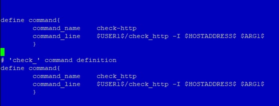

@dlukinski, I haven't seen the command definition yet but if it's using a check_http plugin, I'd probably try to increase a timeout value with -t 40 argument. Can you try that and let us know if that fixes the problem?
Re: CRITICAL - Socket timeout after 10 seconds
Should i edit check_command (check_http! -f follow -I 10.x.x.x -u '/' -p 80) or the command definition (attached)?npolovenko wrote:@dlukinski, I haven't seen the command definition yet but if it's using a check_http plugin, I'd probably try to increase a timeout value with -t 40 argument. Can you try that and let us know if that fixes the problem?
If it's just occurring a single host host then I modify the check definition. If it's multiple host then modify the command definition.
