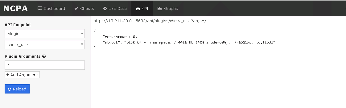

Can we monitor the existing plugins used by NRPE for NCPA agent?
For example,
I have copied the check_disk plugin and I moved to under /usr/local/ncpa/plugins and set the permissions as nagios user.I executed the plugin via NCPA and the ouptut shown.
/code [root@nagios_test libexec]# ./check_ncpa.py -H 10.211.30.81 -t 3RuC3sR3PuS -M '/plugins/check_disk' -a '-w 20 -c 40 /'
DISK OK - free space: / 4416 MB (40% inode=69%); /dev/shm 938 MB (100% inode=99%); /boot 335 MB (74% inode=99%);| /=6525MB;11513;11493;0;11533 /dev/shm=0MB;918;898;0;938 /boot=116MB;456;436;0;476
It showing overall partitions comes under / directory.
When I trying to execute /boot separately .I am getting the below error.
/code [root@nagios_test libexec]# ./check_ncpa.py -H 10.211.30.81 -t 3RuC3sR3PuS -M '/plugins/check_disk' -a '-w 20 -c 40 /boot'
DISK CRITICAL - boot is not accessible: No such file or directory.

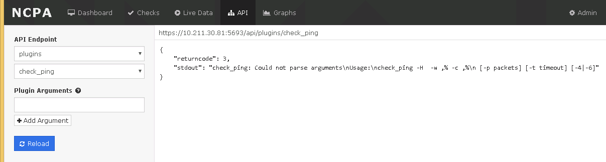

And also I tried to execute check_ping plugin via NCPA and getting the error.
Please find the attached error screenshot.

Re: NSClient 0.4.x compatability on Nagios core 3.5.x
The error from checking the /boot partition might be a a configuration setting in the ncpa.cfg file.
The NCPA agent has a built in disk check you can use instead of using a plugin.
Here is an example command.
/usr/local/nagios/libexec/check_ncpa.py 10.211.30.81 -t 3RuC3sR3PuS  -P 5693 -M 'disk/logical/|boot/used' -w 70 -c 90
The check_ping is missing the requires options and that is causing the error.
check_ping -H <host_address> -w <wrta>,<wpl>% -c <crta>,<cpl>%
