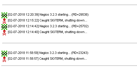

Hello Team,
We are receiving the host down alerts in bulk every day. But when we see, servers are running fine.
When we see the alert history if servers in nagios console, we are seeing the attached message.
Not only for hosts but also services triggering service check timeouts and the message is same as attached.
can you please let us know what needs to be done for not repeating this issue .
we are using the version 3.0.6 core
- Error message getting triggered for host check and service check time out errors
- HST message.PNG (7.03 KiB) Viewed 5498 times

At first, you say you are using Core 3.0.6 but in your screenshots, it's showing 3.2.3?
