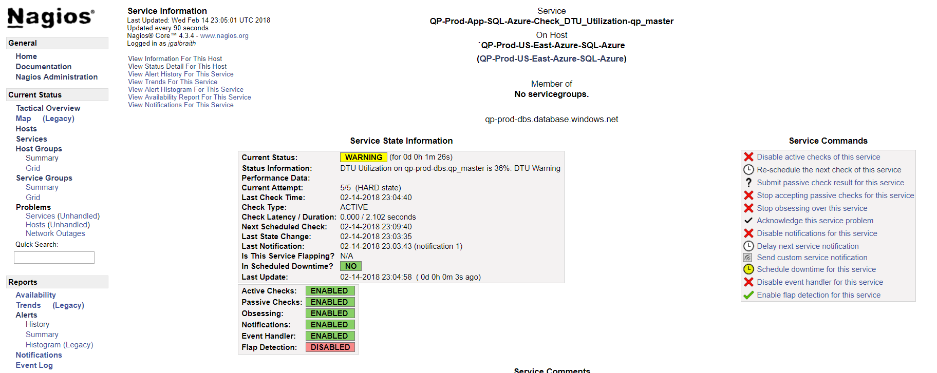

Can you upload a screenshot of the service check output in Core Web interface when it's in a Critical state?

I can see the Service Notification when the service is Warning or Critical in the nagios logs, but the email never actually goes out. The mail logs confirm (no entry) that the email doesn't actually make it to the mail queue.
This is what I see when I tail both nagios.log and /var/log/maillog. As you can see, there are no entries made in the maillog to correspond with the email alert being generated.
==> nagios.log <==
[1518649415] EXTERNAL COMMAND: SCHEDULE_FORCED_SVC_CHECK;QP-Prod-US-East-Azure-SQL-Azure;QP-Prod-App-SQL-Azure-Check_DTU_Utilization-qp_master;1518649414
[1518649416] EXTERNAL COMMAND: SCHEDULE_FORCED_SVC_CHECK;QP-Prod-US-East-Azure-SQL-Azure;QP-Prod-App-SQL-Azure-Check_DTU_Utilization-qp_master;1518649414
[1518649417] SERVICE ALERT: QP-Prod-US-East-Azure-SQL-Azure;QP-Prod-App-SQL-Azure-Check_DTU_Utilization-qp_master;WARNING;SOFT;1;DTU Utilization on qp-prod-dbs:qp_master is 36%: DTU Warning
[1518649418] EXTERNAL COMMAND: SCHEDULE_FORCED_SVC_CHECK;QP-Prod-US-East-Azure-SQL-Azure;QP-Prod-App-SQL-Azure-Check_DTU_Utilization-qp_master;1518649414
[1518649418] SERVICE ALERT: QP-Prod-US-East-Azure-SQL-Azure;QP-Prod-App-SQL-Azure-Check_DTU_Utilization-qp_master;WARNING;SOFT;2;DTU Utilization on qp-prod-dbs:qp_master is 36%: DTU Warning
[1518649420] EXTERNAL COMMAND: SCHEDULE_FORCED_SVC_CHECK;QP-Prod-US-East-Azure-SQL-Azure;QP-Prod-App-SQL-Azure-Check_DTU_Utilization-qp_master;1518649414
[1518649420] SERVICE ALERT: QP-Prod-US-East-Azure-SQL-Azure;QP-Prod-App-SQL-Azure-Check_DTU_Utilization-qp_master;WARNING;SOFT;3;DTU Utilization on qp-prod-dbs:qp_master is 36%: DTU Warning
[1518649421] EXTERNAL COMMAND: SCHEDULE_FORCED_SVC_CHECK;QP-Prod-US-East-Azure-SQL-Azure;QP-Prod-App-SQL-Azure-Check_DTU_Utilization-qp_master;1518649414
[1518649422] SERVICE ALERT: QP-Prod-US-East-Azure-SQL-Azure;QP-Prod-App-SQL-Azure-Check_DTU_Utilization-qp_master;WARNING;SOFT;4;DTU Utilization on qp-prod-dbs:qp_master is 36%: DTU Warning
[1518649423] SERVICE ALERT: QP-Prod-US-East-Azure-SQL-Azure;QP-Prod-App-SQL-Azure-Check_DTU_Utilization-qp_master;WARNING;HARD;5;DTU Utilization on qp-prod-dbs:qp_master is 36%: DTU Warning
[1518649423] SERVICE NOTIFICATION: CloudServices-QPS-Admin-Email-contact;QP-Prod-US-East-Azure-SQL-Azure;QP-Prod-App-SQL-Azure-Check_DTU_Utilization-qp_master;WARNING;notify-service-by-email;DTU Utilization on qp-prod-dbs:qp_master is 36%: DTU Warning
