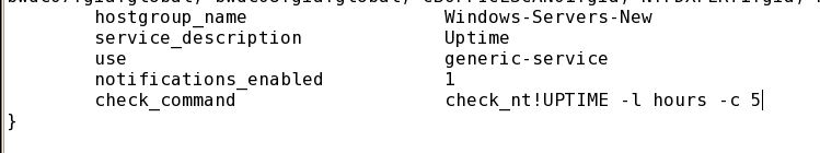

i am using the plugin check_nt with the NSCliet++ .
i tried to define the threshold for UPTIME of the server as follows:
check_nt ! UPTIME -l hours -c 5
But it is not generating the alert.
i have attached the screenshot from the file services.cfg
kindly refer to it and suggest where i am wrong.

In order to assist further, can you post the command you are trying to configure running it from the command line, and can you also show the configuration you have for the check_nt check command

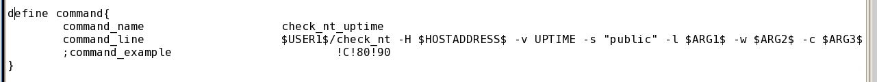

i searched in the server and found the file name as checkcommands.cfg
But UPTIME was not defined there.
I defined it in the file as per the screenshot attached.

Your picture in the first post is calling a command called check_nt This picture is check_nt_uptime
we need to see check_nt

- DevOps Engineer
- Posts: 19396
Re: UPTIME Threshold
it's in there
You are missing 1 !
So you should be able to test this from the command line running (replacing IP_ADDRESS with a real IP
The check_command line in your OP should bedefine command{
command_name check_nt
command_line $USER1$/check_nt -H $HOSTADDRESS$ -p 12489 -s secret-password760 -v $ARG1$ $ARG2$
check_nt!UPTIME!-l hours -c 5So you should be able to test this from the command line running (replacing IP_ADDRESS with a real IP
./check_nt -H IP_ADDRESS -p 12489 -s secret-password760 -v UPTIME -l hours -c 5
