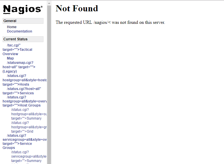

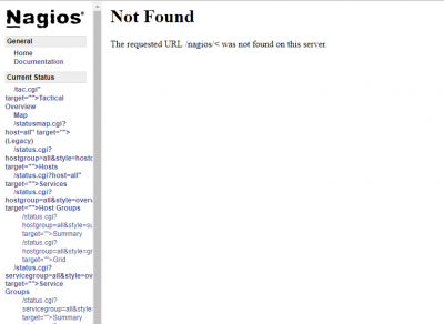

Kindly find the attachment what was wrong because I can see the web UI but there are some errors. Please advice
Re: install Nagios Core
Looks like you do not have php installed
Did you run this from the doc?
yum install -y wget httpd php gcc glibc glibc-common gd gd-devel make net-snmp unzip
