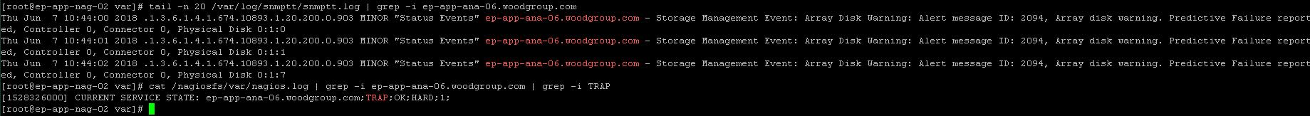

I have configured the snmp trap monitoring on the nagios core. I am receiving the traps on /valog/snmptt/snmptt.log, but the traps are not processing it is showing empty for the TRAPS for the server (ep-app-ana-06.woodgroup.com) in nagios.log. Could you, Please help with it.
Attaching the snmptt.ini, snmptt.conf and snmptt.log
[root@ep-app-nag-02 var]# cat nagios.log | grep -i ep-app-ana-06.woodgroup.com | grep -i trap
[1528066800] CURRENT SERVICE STATE: ep-app-ana-06.woodgroup.com;TRAP;OK;HARD;1;

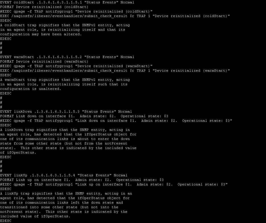

This entry in the snmptt.conf file
Has an empty EXEC command which is used to send the received trap to the Nagios process.
You need to put an EXEC line in that OID like the example below.
Another thing I see if that there are 2 different paths for the submit_check_result script.
Make sure that they are both valid or change the invalid one to the correct one.
EVENT authenticationFailure .1.3.6.1.6.3.1.1.5.5 "Status Events" NormalYou need to put an EXEC line in that OID like the example below.
EXEC /nagiosfs/libexec/eventhandlers/submit_check_result $r TRAP 1 "SNMP authentication failure"Code: Select all
/usr/lib64/nagios/plugins/submit_check_resultBe sure to check out our Knowledgebase for helpful articles and solutions!

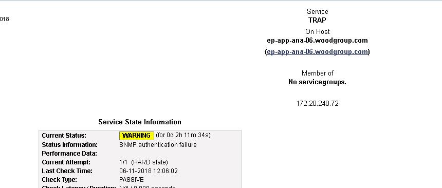

Re: Traps are not processing
su - nagios
/nagiosfs/libexec/eventhandlers/submit_check_result ep-app-ana-06.woodgroup.com TRAP 1 "SNMP authentication failure"Code: Select all
grep -i ep-app-ana-06.woodgroup.com /nagiosfs/var/nagios.log | grep -i trapThe entries in the snmpttunknown log have to be added to the snmptt.conf file so they will be processes.

Hi Tgriep,
Thanks for the help.
I have run the below command and the TRAP is generated on the nagios console.
Could you, Please let us known how to add the traps receiving in the snmpttunknown.log to snmptt.conf file.
FORMAT SNMP athentication failure
#EXEC qpage -f TRAP notifygroup1 "SNMP authentication failure"
SDESC
An authenticationFailure trap signifies that the SNMPv2
entity, acting in an agent role, has received a protocol
message that is not properly authenticated. While all
implementations of the SNMPv2 must be capable of generating
this trap, the snmpEnableAuthenTraps object indicates
whether this trap will be generated.
EDESC
