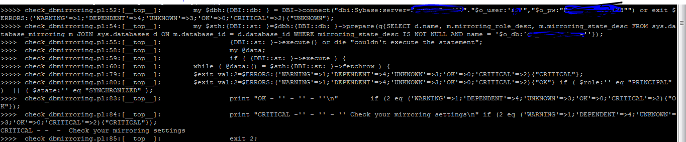

I tried this plugin (https://exchange.nagios.org/directory/P ... ng/details) with sa account, It always gives Critical and it seems that it is not able to fetch the row. I used Dumptrace to see the logs, and found nothing, attached the log for reference.
Could anyone please help if you come across this or any other method to monitor mirror status.

I ran the query from Db and it is working fine, I ran Dumptrace also from the command line, it seems the query returns nothing. I always get Critical with no values.

No one here wrote this plugin, so it's tough to say what the original intention of the plugin was. All of the below is based on my own knowledge of Perl and TSQL.
Though this plugin was written against SQL Server 2005, I don't think the underlying sys tables haven't changed much though so that shouldn't matter.
All that plugin does is run this query:
It then compares the role and state (m.mirroring_role_desc, m.mirroring_state_desc) of that query and checks to see if role is "PRINCIPAL" and state is "SYNCHRONIZED". If that query returns anything else, the plugin returns a CRITICAL state.
Troubleshooting probably starts with running that query yourself and seeing what it churns out.

SELECT d.name, m.mirroring_role_desc, m.mirroring_state_desc
FROM sys.database_mirroring m
JOIN sys.databases d ON m.database_id = d.database_id
WHERE mirroring_state_desc IS NOT NULL AND name = '<the -d value>'Troubleshooting probably starts with running that query yourself and seeing what it churns out.
