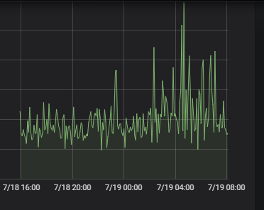

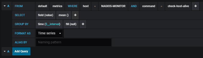

hmm, well it seems that I can create graphs manually. Though I don't know how to make a graph and I don't get the same options as in the link you posted I'm still able to add a query and add
"WHERE host =" and I get a list of all the hosts. I managed to get a graph from the check-host-alive command for a host and it looks like this:
Query
Query
Graph
Graph
And when I was adding the data source it says it is working.
So it seems that Grafana is able to get the data from the InfluxDB.
So it seems to be a problem with the Histou addon in Grafana then?
