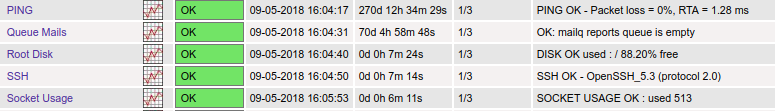

Hi All,
I am curious about the duration time of my node services in nagios server. As i have restarted the server, When it came back the duration time of some services are less than one minute such as 0d 0h 0m 33s and some of the services duration time 270d 12h 40m 41s . Whats wrong with the nagios, It doesn't monitor the real time duration. Please find attached screenshot for your reference.
I am using nagios 4.4.1 and nrpe v2.15
Thank you,

The duration is how long it has been in the current state. If the state changes on these it would reset.
Also, there are retain_status_information and retain_nonstatus_information directives for host/service objects that can be set on the service that would reset these if disabled

The definition of both is here and they are enabled by default
First, I would look in the Alerts -> History report to see if these services changed state recently.
If they did, this would explain everything.

History report of PING Service:
When host is down:
When it comes up:
When host is down:
[09-05-2018 16:29:27] SERVICE ALERT: Server-01;PING;CRITICAL;SOFT;1;PING CRITICAL - Packet loss = 100%Code: Select all
[09-05-2018 16:34:21] SERVICE ALERT: Server-01;PING;OK;SOFT;1;PING OK - Packet loss = 0%, RTA = 0.59 ms-

Ok, at that time the duration will start again at 0d 0h 0m 0s
Now, if your server recovered before the other items were checked again, they will still show the longer duration because they never experienced a non-OK state
Re: Incorrect Duration Time
But it shows critical PING;CRITICAL . When its recovered, the state changed and duration time still the same before going down. Why ?

I just looked again and see you are running 4.4.1
There were several bugs in 4.4.1 that relate to this that are fixed in 4.4.2

Only Core would need upgrading, here is the documentationrlinux57 wrote:Okay. How could i Upgrade it and Is it necessary to upgrade nagios plugins on server and nrpe on host machines. Please mention the link as well.
https://support.nagios.com/kb/article/n ... e-797.html
