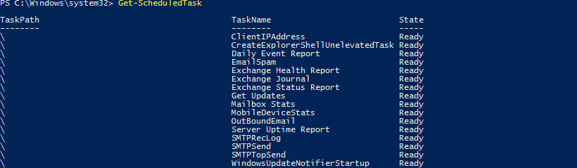

So I have two Servers running Exchange and they both have the same scheduled tasks
The check fails Critical Exchange Journal NOT FOUND
I ran from command line with same result.
From Node 2 it fails
root@serv017:/usr/local/nagios/etc/objects/windowsservers# /usr/lib/nagios/plugins/check_nrpe -t 50 -H SERV021-N2 -c check_tasksched -a "filter=title eq 'Exchange Journal'" 'critical=most_recent_run_time < -1w' empty-state=critical 'empty-syntax=CRITICAL: Exchange Journal NOT found' 'detail-syntax=${title} is stale more than -1w'
From Node 1 it works.
root@serv017:/usr/local/nagios/etc/objects/windowsservers# /usr/lib/nagios/plugins/check_nrpe -t 50 -H SERV021-N1 -c check_tasksched -a "filter=title eq 'Exchange Journal'" 'critical=most_recent_run_time < -1w' empty-state=critical 'empty-syntax=CRITICAL: Exchange Journal NOT found' 'detail-syntax=${title} is stale more than -1w'
: All tasks are ok|'Exchange Journal_exit_code'=0;0;0 'Exchange Journal_most_recent_run_time'=1539637200;0;1539044570
I attached some images.
The attachment Exchange Journal Task.PNG is no longer available
Powershell view
Powershell view
the task
the task
Exchange Journal Task.PNG (4.91 KiB) Viewed 3297 times
I deleted the task and recreated it no luck
Any ideas
Thank you
Tom

Problem was on the Schedule Task on the Windows 2016 Server
It was marked as hidden unchecked the box and like that the check is now working.
Please Lock this as resolved.
Thank you for all the help
