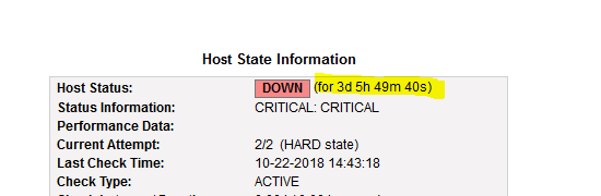

Re: Status Age display for Last Check time
They do, see highlighted field
Post by cdienger »
Which version of core are you using? My 4.4.1 machine is showing the duration on both the host status and service status details screen. Please provide a screenshot to clarify where you'd like to see it added if needed.
