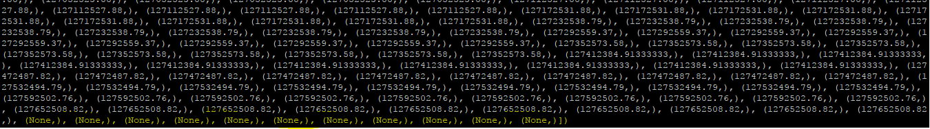

I have configured the devices and pnp4nagios tool is configure correctly but the issue is when performance data is created they show me last 10mins of data in none none format but after 10 mins it shows full data but the last 10mins value is same. So anyone can help me to sort out this.
I have attached the screenshot please see the performance data file.

Can you provide the command that you are running that you are using to output that data from your screen capture?
Re: Performance Data Issue Nagios Core
I am using this below commands:-
1) python
2) import rrdtool
3) rrdtool.fetch("Uptime.rrd","MAX")
then it shows the data for Uptime service.
It looks like you are running some sort of plugin that gathers the Uptime of some system.
Make sure it is running at the times you need.
I found this link that has a possible explanation on what you are seeing.
https://stackoverflow.com/questions/472 ... one-object
If there is no data at the time you ran the fetch, it will display as None since there is no data to display.
Also, you are not specifying a time frame for the fetch.
You should take a look at these links that details how the data is stored in the RRD files.
https://oss.oetiker.ch/rrdtool/tut/rrd- ... rs.en.html
https://www.loriotpro.com/Products/On-l ... RRD_EN.htm
Every time the plugin runs and outputs the performance data, it add it to the rrd file with a time stamp for when it is put in.
It does not remove the previous data entry so when you run the FETCH command, it will display the last data points unless you specify a time.
