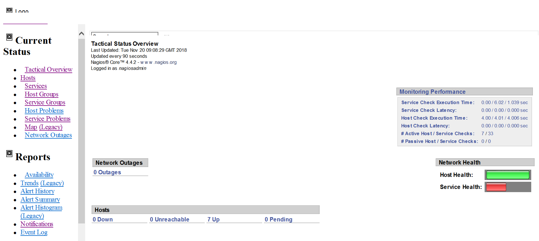

^^ I used one of the skins from here. The configurations I made were simple.
---- wget <download URL for the skin>
---- unzip <filename>
---- cp <filename> -d /usr/local/nagios/share
---- service nagios start
I have also attached the screenshot of my web GUI
Re: Nagios Background Theme Change
Being you overwrote your current /usr/local/nagios/share with the ones in the theme the best way to get them back would be to re-compile and install core.
