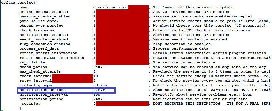

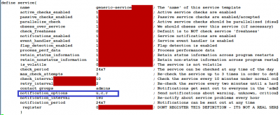

I use the default template "generic-service" for my services, I have removed the notifications for the warning state in this template, but I continue to receive them, I don't understand why.
Of course I relaunch the nagios service but always worry. Do you have any idea ?

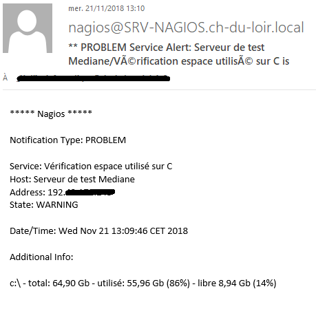

Re: Notification problems
So you are receiving an email notification for this service? Is that correct?
Can you share a screenshot of the notification?
Post by ChCDL »
Yes, the screenshot :

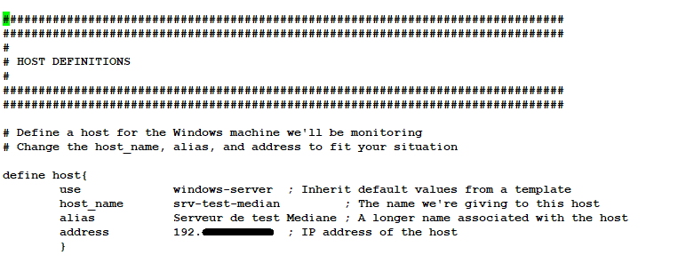

This isn't the same host/service...
The host in your first screenshot of the object definition is srv-test-median

The notification is about the service, not the host. This is indicated in the mail's object "Verification espace utilisé sur C". Srv-test-median is the one concerned.
In the mail what is written in host, is just the alias I defined in the host's file, see below :
