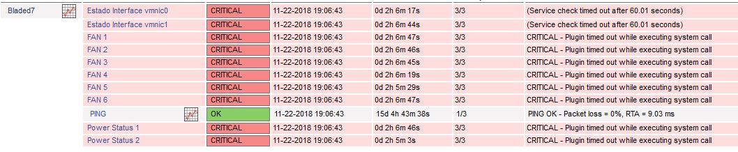

Until yesterday, my Nagios server was working fine but for no apparent reason the attachment message started to appear in the graphic interface.
All related to the plugin check_snmp .. I was looking for information on the link https://support.nagios.com/forum/viewto ... =7&t=44016
but I can not solve the problem
It should be noted that when I execute the commands from Centos the same message also appears
CRITICAL - Plugin timed out while executing system call
Could you please indicate to me what can be done, it should be stated that the nagios was working well, I do not remember making any changes to the plugin.
Error SNMP
Error SNMP

This error started appearing recently .. after 10 days I added the affected hosts, it is necessary to specify that it was working well, now I have 62 host in my nagios including the localhost.
It should be noted that sometimes I get notifications of loss of connection to devices but then 05 seconds later the computer appears online again ... of course it never went out or disconnected.
I have Nagios Core 4.4.1 installed in a Centos 7, 2 core virtual machine, HD 100 Gb and 6 Gb memory
Also, I have performed some tests:
- I applied the snmpwalk command to the device as root user and nagios with Ok results.

Did you login to the remote server and verify that it is still running the SNMP daemon and that there were no changes done to the configuration settings?
What is the remote device?
What OS and release is it running?
If the device is setup to respond to SNMP version 2 polls, run the following command on the Nagios server to see if it responds.

Dear
After research confirm that one of my colleagues who also works with me in the implementation of the nagios in my work copied some MIBS files to try to monitor a Cisco UCS team and that day is that the errors appeared. this afternoon after eliminating these MIBS the incident was resolved.
1000 thanks ..
