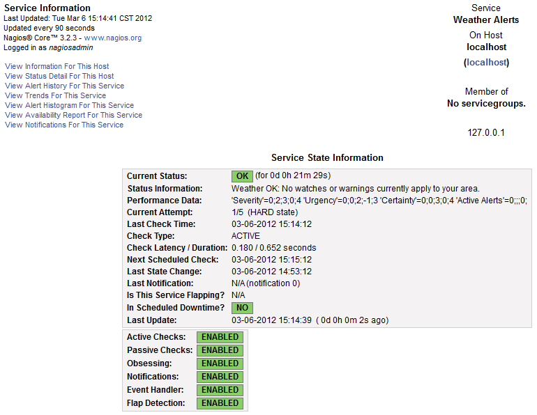

Download the plugin and put it in the "/usr/local/nagios/libexec" directory.
Make it executable:
# chmod +x /usr/local/nagios/libexec/check_cap
In order to see the options, run in terminal:
# cd /usr/local/nagios/libexec
# ./check_cap -h
Create a command definition. It may look something like this:
       command_name                             check_cap
       command_line                             $USER1$/./check_cap -s MN -l 027123 -w Moderate -c Severe
Create a service definition. (I added this service to my localhost, but you can set it up your own way). It may look something like this:
        host_name                       localhost
        service_description             Weather Alerts
        display_name                    Weather Alerts
        check_command                   check_cap!!!!!!!!
        max_check_attempts              5
        check_interval                  1
        retry_interval                  3
        check_period                    nagiosadmin_notification_times
        notification_interval           60
        first_notification_delay        0
        notification_period             nagiosadmin_notification_times
        notification_options            w,u,r,c
        notifications_enabled           1
        contacts                        nagiosadmin
        register                        1
Make sure you don't have any configuration errors:
Note: Paths may vary on your machine.
Restart nagios:
service nagios restart
Log in the web interface. You should see something like this:
