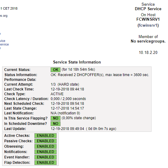

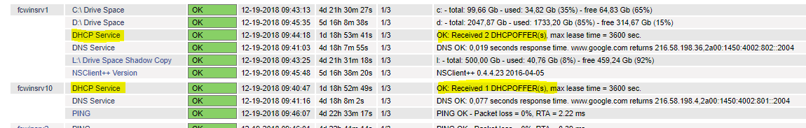

but on service page the status is:
Status Information: OK: Received 2 DHCPOFFER(s), max lease time = 3600 sec

Can you upload a service status screenshot of the DHCP Service --> host fcwinsrv1(from the web interface)? Also, please upload the status.dat file:
Thank you./usr/local/nagios/var/status.dat
Re: check_dhcp on DHCP servers on balanced mode
...and the status.data
status.dat.txt- (73.07 KiB) Downloaded 270 times
- nag_dhcp04.PNG (3.72 KiB) Viewed 4692 times

@nlabardi, Is your check_dhcp command defined like this?
I noticed that both of your service check commands have this argument - "DHCPOFFER".$USER1$/check_dhcp $ARG1$
But when you ran commands from the command line you did not use this argument. I suggest deleting DHCPOFFER from both command definitions and restarting the nagios service:check_dhcp!DHCPOFFER -s 10.18.2.20 -m 123456789012 -r 10.18.2.254 -i eth0 -u
check_dhcp!DHCPOFFER -s 10.20.2.20 -m 123456789012 -r 10.18.2.254 -i eth0 -u
service nagios restart
YESSSSSSSSSS
everything works well
thank you!!
