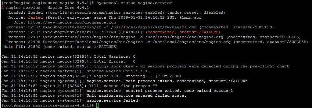

and when I run systemctl status nagios.service I get nagios.service failed. I will upload screenshot to view error message.
During install I did encounter an issue. When I attempted to Start Service / Daemon by entering systemctl start nagios.service, I received error message "nagios.service failed because the control process exited with error code. See "systemctl status nagios.service" When I entered systemctl status nagios.service it said it could not locate nagios.cfg in "/usr/local/nagios/etc/nagios.cfg".

My next step I wanted to confirm Nagios is running by entering systemctl status nagios.service and I receive error message nagios.service failed.
