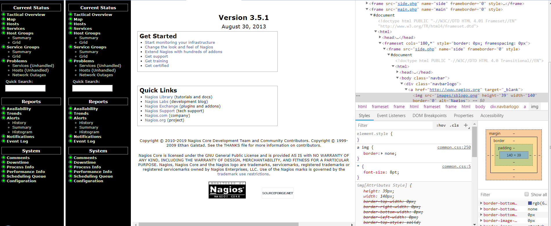

i encountered a strange issue with the nagios web interface . From time to time , something is duplicating the sidebar .I cant find errors inside the apache log to indicate the root couse Has anyone encountered a similar error ?

My guess would be that there is a link somewhere that is loading the whole from insude the main frame target.
I tried to replicate this on current versions but could not find any links that caused this. Being this specific version is over 5 years old you may want to consider working toward an upgrade.

thank you for investigating this.The first problem that i noticed came from index.py script which was trowing an internal server error on the webpage for every logged error ( for example when a user failed to authenticate), which honestly we dont need to be shown as internal server error on the webpage .I tried to make an exception , so i changed as a test the value from error to crit . The internal server error does not appear anymore, but instead the sidebar is beeing duplicated .
if req.myfile == "crit":
try:
show_apache_log(req)
return apache.OK
except Exception, e:
req.write("<html><body><h1>Internal Error</h1>Cannot output error log: %s</body></html>" % e)
return apache.OK
That was my taught as well , that something is calling that link twice , but cant figure out what...
index.py
index.py
(9.42 KiB) Downloaded 117 times

Ok, this makes sense.. index.py is not part of nagios, this file was created by OMD, not Nagios.
Unfortunately I cannot help with non-nagios items.
