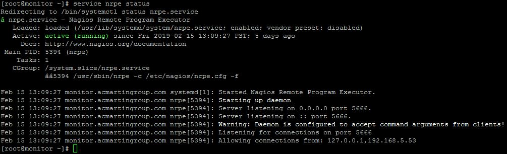

I'm not 100% convince nrpe is the issue because when I enter netstat -nap | grep 5666 I do see port 5666 open and nrpe is listening. I'll attach pic.
also, when I enter service nrpe status I get output active running, and get a warning that Daemon is configured to accept command arguments from clients. I'll attach pic so you can see.

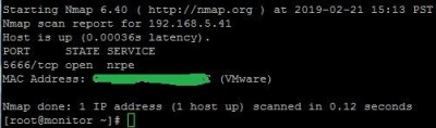

It sounds like there may be a firewall blocking tcp port 5666. Run the following on the XI command line to check:
nmap ubuntu_machine_ip -p 5666

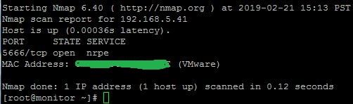

I ran nmap command and Ubuntu port 5666 does appear to be open. I attached pic.
I wonder what is causing this issue. My Windows machines are being monitored but none of my Linux servers aren't working. Then again nrpe isn't installed on Windows servers. I'm using NSCLient for Windows.
