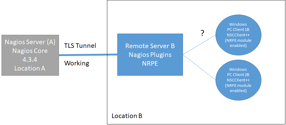

I have two Nagios server, A (Nagios Core 4.3.4) - Local Nagios, and B the Remote Nagios Server (NRPE, Xinetd, Nagios plugins).
I have configured them and installed with NRPE, (following the manual here) so now I can monitor my B Remote Server where the plugins are also installed-
Now the complex Second step:
The Remote Server B has Windows clients which are only reachable from the location B, from that Remote Server B; (only when accesesing Remote Server B). So there is no connection from Nagios Server A to Clients at the location B directly, it has to be connected/reported through the Remote Server B. PC Clients on the Location B, have the NSCP Client (NSClient++) installed with the NRPE module enabled. I want to configure them to get them monitored reported from server A.
When executing the NRPE command on the Nagios Server A - I get the SSL Error for the Remote PC Client 1B

Structure of the Set-Up - remote Location  B

As long as check_nrpe is on server A and server B it's definitely doable, we just need to make sure we're passing the correct stuff and fix what is likely an SSL/version issue.
So essentially you're going to do something like this:
Nagios A runs:
/usr/lib64/nagios/plugins/check_nrpe -H 'NAGIOSB' -c check_nrpe_external -a "'Remote PC Client B1 IP/DNS Name' 'PCB1_nsclient_command_to_run'"
Nagios B would have this in its nrpe.cfg:
command[check_nrpe_external]=/usr/local/nagios/libexec/check_nrpe -H $ARG1$ -c $ARG2$
Which would then reach out to Remote PC Client B1 and check what it needs to check.

 UNKNOWN
NRPE Plugin for Nagios Version: 3.2.1
how to pass the arguments in the LocationB.cfg file, it is the last step, any hint will help me. I am also a bit not understanding the complete set-up, as when I do the same commands on the SERVER A, with a different plugin, i am getting different anwers, not desired answers. I am doing something wrong, or is this a bug in the NRPE
For example when checking the amount of users on the remote PCClien1B from Server A in the command line:
[root@TestNagiosA]# /usr/local/nagios/libexec/check_nrpe -t 90 -H IPofServerB  -c check_nrpe_external -a IPofPCClien1B -n check_users -w 2 -c 3

Here is what worked for me:
NAGIOSA:
    use                    generic-service
    host_name              ClientPC1B
    service_description    Remote_CPU
    check_command          check_nrpe_ext!192.168.5.232!check_cpu!'-a show-all'!!!!!
    register               1
    command_name    check_nrpe_ext
    command_line    $USER1$/check_nrpe -t 90 -H $HOSTADDRESS$ -c check_nrpe_external -a $ARG1$ $ARG2$ $ARG3$
NAGIOSB /usr/local/nagios/etc/nrpe.cfg:
command[check_nrpe_external]=/usr/local/nagios/libexec/check_nrpe -t 90 -H $ARG1$ -c $ARG2$ $ARG3$
Since your ClientPC1B NSClient++ agent doesn't use SSL, yours would be:
command[check_nrpe_external]=/usr/local/nagios/libexec/check_nrpe -t 90 -H $ARG1$ -n -c $ARG2$ $ARG3$

Hello ssax,
Thanks for your reply, and for the help in the syntax, but I am not fully undersdanding it yet. I have now another additional question which I do not understand. It does not work for me as you said, and I may think 192.168.532 is the equivalent to my NagiosB server, and the command check_cpu always worked, but not with the syntax specificied below:
    use                    generic-service
    register               1
When executing the "part" of the command on NagiosB server on the terminal it works fine, with the check_cpu example, but not with the others - I get the message the commands are not found as for example, check_users - command not known - which it can be found on the defined directory /usr/lib64/nagios/plugins/, but It does not find the check_cpu on my NagiosB server.
[root@TestNagiosB]# find / -name check_cpu
[root@TestNagiosB]#
and also check_cpu is not defined in the nrpe.cfg, from where it execute then ?
[root@TestNagiosB]# /usr/local/nagios/libexec/check_nrpe -t 90  -H IPofPCClient1B -n -c  check_cpu 'show-all'
OK: CPU load is ok.|'total 5m'=0%;80;90 'total 1m'=0%;80;90 'total 5s'=0%;80;90
[root@TestNagiosB]# /usr/local/nagios/libexec/check_nrpe -t 90  -H IPofClient1B -n -c  check_users
Unknown command(s): check_users
[root@TestNagiosB]# /usr/local/nagios/libexec/check_nrpe -t 90  -H IPofClient1B -n -c check_users '-w 2 -c 3'

[root@TestNagiosB]# find / -name check_users
/usr/lib64/nagios/plugins/check_users
and of course in the file *.cfg I get an error as well, any help will be appreciate, and not only a recipe, I need to understand it and to know how it works.
thanks,
X.
