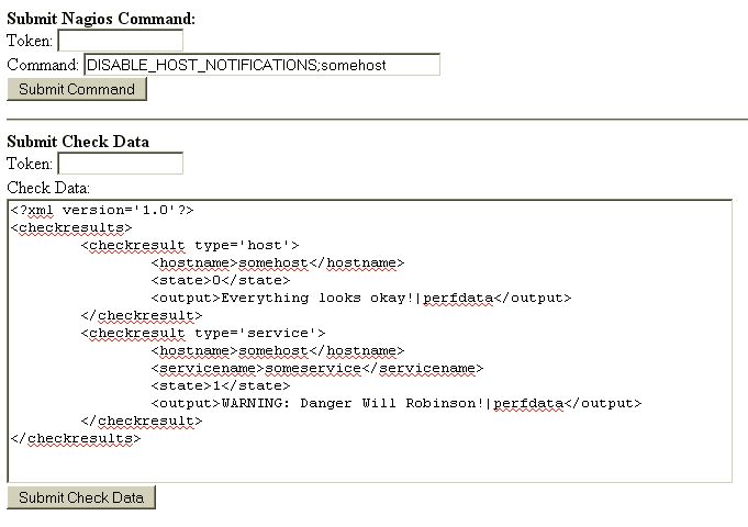

I followed the installation procedure that I found in http://assets.nagios.com/downloads/nagi ... erview.pdf (except that I use "cp nrdp.conf /etc/apache2/conf.d" as the place for the webconfig)
Then I opened the URL http://<ipaddress>/nrdp
I'm getting the screen like the attachement.
I'm able to use the first part of this interface (submit nagios command).
I'm not able to use the second part of the interface (with altered data that exists in the nagios config of course)
The next step is using the php client. I'm able to run this client with all the proper parameters but nagios is not getting anything ...
If I was able to debug the NRDP process, I would get some more details where it's going wrong. Is this possible ?
Thanks,
Kris
Thanks,
Kris

When you submit data with the "Submit Check Data" what is returned?
Do you already have the cfg for the host/service you are submitting?

I'm actually seeing the exact same behavior. I followed the document to the letter, and I'm testing with a brand new server and install of nagios core.
The "Submit Nagios Command" works perfectly, but the "Submit Check Data" it never seems to hit nagios.
The output on the webpage is:
<result>
<status>0</status>
<message>OK</message>
<meta>
<output>2 checks processed.</output>
</meta>
</result>
But monitoring the nagios log file and the nagios.debug file with it set to debug external commands nothing displays.
I do have the configurations for the host/services already defined.

Here are my access and html logs. I hadn't noticed the timezone error before, it doesn't occur when I use the "Submit Nagios Command" section:

I updated my php.ini file and have resolved that error, now the logs aren't showing anything when I submit but it's still not working.
Should I increase the logging level of httpd?
***Update*** I increased the log level to dubug, and still did not see any errors.

Looking around some more I see it's creating files in my /tmp directory:
-rw-r--r--. 1 apache apache 0 Apr 16 08:26 cy8wSSw.ok
-rwxrwx---. 1 apache nagcmd 238 Mar 30 16:41 cYNHIQs
-rw-r--r--. 1 apache apache 0 Mar 30 16:41 cYNHIQs.ok
-rwxrwx---. 1 apache nagcmd 238 Apr 10 08:41 czGG3iA
-rw-r--r--. 1 apache apache 0 Apr 10 08:41 czGG3iA.ok
-rwxrwx---. 1 apache nagcmd 236 Apr 17 13:09 czUKjvG
-rw-r--r--. 1 apache apache 0 Apr 17 13:09 czUKjvG.ok
It looks like when nrpd is done it creates the *.ok file so the nagios core can pick it up and process it.
This is either not happening or happening too fast for me to catch it with the nagios command
