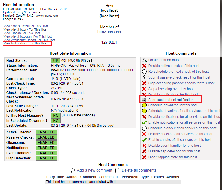

Assuming that is configured correctly, try sending a custom notification from the web interface and check your mail log, /var/log/maillog, for errors.

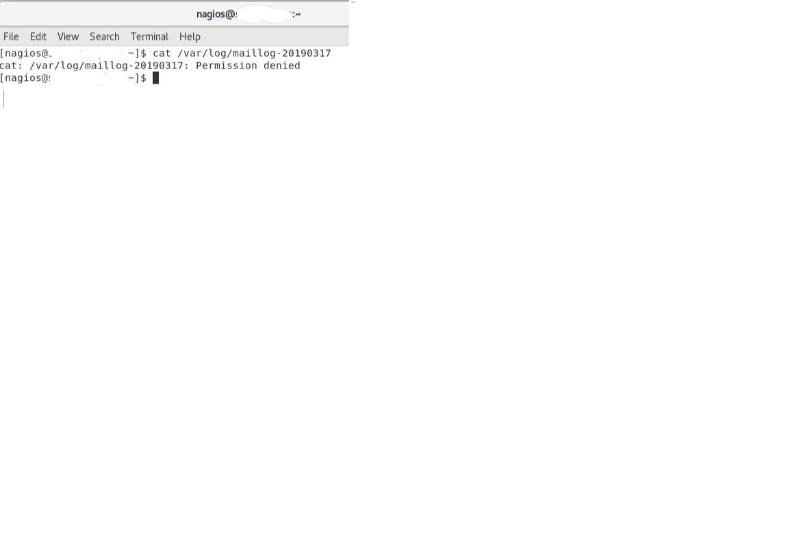

I have attached the contacts and windows.cfg and capture of maillog. To answer "...try sending a custom notification from the web interface and check your mail log" I don't know how to do this. I went to the web interface but I don't see any link for email. Thank you for your help.

You can see if Nagios tried to send a notification in log file ( /usr/local/nagios/nagios.log ) or take a look at the reports available in the web interface ( see attached image).
