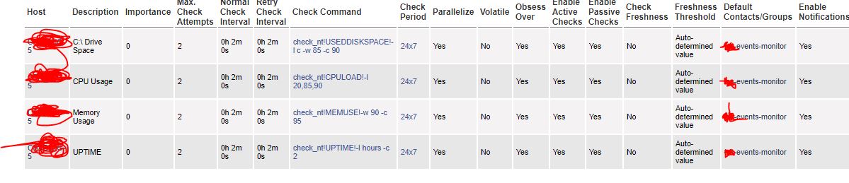

It is not in the notifications report.
When i see the configuration report it is defined to send the Alert Notification , also screenshot attached for your referrence.
When i see the trends for that service it shows the critical but no alert generated during that time.

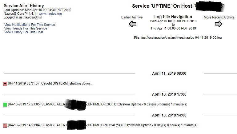

Can you show the alert summary report for this service?
amitgupta19
- Posts: 286
