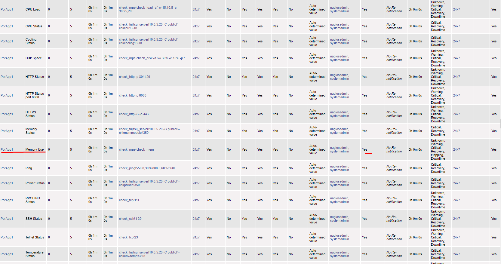

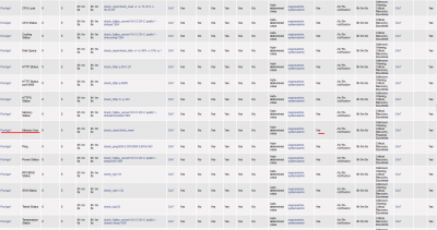

when memory hits warning or critical status i still getting notified via email even if i commented the notification command at the service check.
Why this happens?

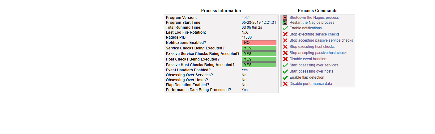

Also at nagios.cfg i have the following statement
# NOTIFICATIONS OPTION
# This determines whether or not Nagios will sent out any host or
# service notifications when it is initially (re)started.
# Values: 1 = enable notifications, 0 = disable notifications
enable_notifications=0
nagios.cfg

orani
Posts: 169
Joined: Wed May 06, 2015 3:33 pm
Re: Mail Notification problem
Post by orani »
Ok. That worked perfectly for me. But in nagios.cfg i had already disabled the global notification settings and still nagios was sent mails. Why was that happening?
orani wrote:Ok. That worked perfectly for me. But in nagios.cfg i had already disabled the global notification settings and still nagios was sent mails. Why was that happening?
there is also a runtime level that overrides the configuration.
If someone enabled then through the GUI it would override the config value
system -> Process Info -> Enable notifications (will show as "Disable notifications" if they are enabled)
orani
Posts: 169
Post by orani »
If you check my previous attachments you will see that i have disabled notifications on both the gui and the nagios.cfg, restarted the service but still receiving notifications.
Sorry, I missed seeing that image.
